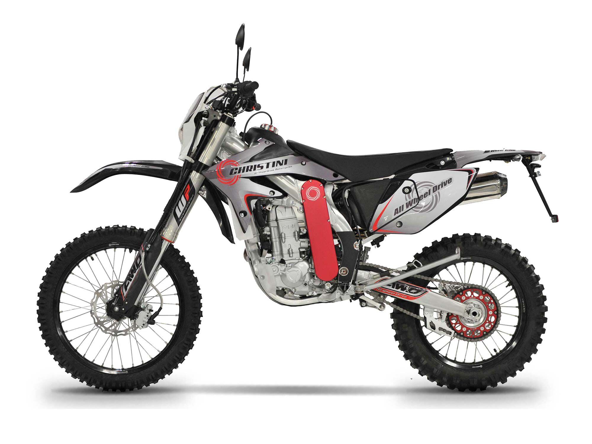

Christini produces AWD motorcycles for the military and public, but the production numbers are small. (Christini/)So far the market has not made it notably profitable to produce mainstream two-wheel-drive bikes, and a front electric drive hub requires battery, power supply, and control electronics to encourage cooperation between front and rear wheel torques. Electric drive is surely a considerable control improvement over chains and sprockets, a flexible shaft, hydraulics, or other previous attempts, but it remains extra weight without a full-time purpose.
